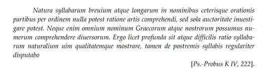

There is some evidence that even Roman grammarians admitted struggling with Latin accentology, e.g. Probus wrote this (taken from Belov 2005):
Since there is a significant number of exceptions (all of them are rara), I will focus on oxytones for now. The following is my summary of relevant parts in Leumann, Hofmann, and Szantyr 1977, Tronskii 1960, and Weiss 2009/2011.
