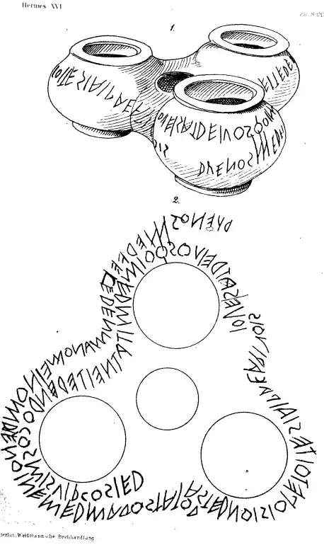

In the earliest inscriptions, too, you can see a lack of word division or punctuation. Take a look at the Duenos Inscription (ca. 580–570 BCE):

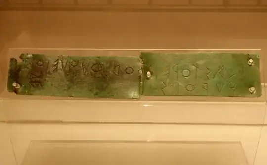

However common this was, there were some variations. In a dedication to Castor and Pollux (ca. 550–525 BCE) in between "to Castor" (CASTOREI) and "to Pollux" (PODLOUQUEI) there is word division indicated by an interpunct ·.

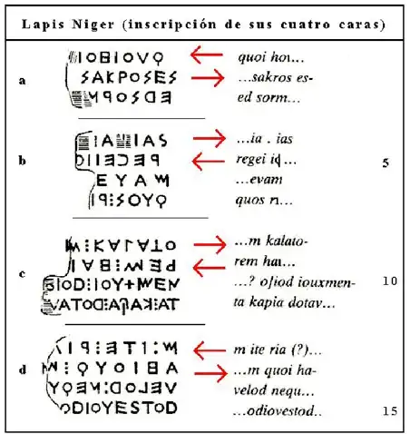

The interpunct was most often used for word division in inscriptions. Sometimes, there may be two dots, even three as evident from the Forum Inscription (6th century):
You may also note in that inscription that a slash \ is used for sentence division.

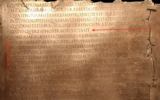

Indentation as well as empty space was used in longer texts to mark paragraphs, e.g in the Lyon Table.
