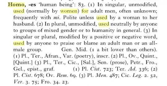

As for the idiomatic, actual use of homo in Latin as a form of address, here's an illustrative entry from Dickey 2002 ("Latin forms of address: From Plautus to Apuleius"):

    Thanks! This whole question seems to have been side-tracked by the question of whether homo is epicene or common, but that's really only tangential to my actual question, which is whether homo can be used of a single woman, regardless of its grammatical gender. – brianpck Feb 10 '17 at 18:21
  • Epicene nouns can be used for masc. and fem. referents and the biological sex of the referent cannot overwrite the grammatical gender of the noun. – Alex B. Feb 10 '17 at 18:26
    Exactly: so my question is not whether I need to write "Aemilia est homo bonus" or "...bona" but rather whether homo is an appropriate choice at all. (Assuming the answer to the second question is "yes," the first question immediately becomes interesting.) – brianpck Feb 10 '17 at 18:28
    @brianpck Perhaps you could add that remark to your question. It would help to further clarify that you are not interested in the gender of the word homo, but in whether it is appropriate for a woman. – Joonas Ilmavirta Feb 10 '17 at 19:02
