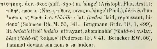

Etymological Dictionary of Greek by Robert Steven Paul Beeke & Lucien van Beek doesn't mention the meaning "small/dwarf" in the article on píthēkos, no more than Dictionnaire étymologique de la langue grecque by Boisacq,

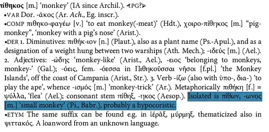

just the former mentions a detail relative to that semantic area:
Isolated is pithon/pithonos, [m.] 'small monkey' (Pi., Babr.), probably a hypocoristic.
That form is related to Pindarus, which is old enough, but seemingly just a diminutive of "monkey".
The semantic connection between "(small) monkey" and "small man, dwarf" seems probable (maybe large monkeys were hard to see in the past and all of them were imagined small) but if that is so the "dwarf" meaning of pithekos should be more common in classic and Byzantine Greek than a single occurrence in Procopius' book.
