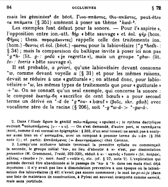

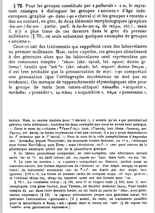

Not an answer, but FWIW here is Lejeune's discussion in Phonétique historique du grec.
enter image description hereenter image description here
