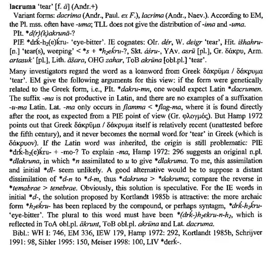

lacruma (dacruma - three attestations only, all by the grammarians only - Mar. Vict., Keil 6.26.2) (Anlaut l/d variation)
lacruma < PIt. *d(r)(k)akrunā-? < PIE *drḱ-h2(e)ḱru- 'eye-bitter' (Kortlandt 1985b)
Italic comparanda: not listed
IE comparanda: Skt. áśru-, YAv. asrū [pl.], Gr. δάκρυ, Arm. artasuk' [pl.], Lith. ãšara, OHG zahar, ToB akrūna [obl.pl.] 'tear'; OIr. dér, W. deigr 'tear', Hit. išhahru- [n.] 'tear(s), weeping'
Beekes: "A Hell. form *δάκρῠμα is often assumed to be the source of Lat. dacrŭma, lacrĭma, but see now the discussion in De Vaan 2008 s.v. dacruma ."
Attestations of δάκρῡμα -ατος, τό: Beekes: δάκρῡμα 'mourned for' (Orac. apud Hdt. 7, 169), 'tear' (A.): cf. Montanari (BDAG): tear, lament Aeschl. Pers. 134; Eur. Andr. 92 ( pl. ); cause of weeping: Opp. ( Hdt. 7.169.2) .
cf. pl. δάκρη (δάκρῠ)
Re: δάκρῡμα < *δάκρῠμα in Greek, see Biville 1995: 28-29, 128

For ease of reference, here's de Vaan's entry for lacruma.
