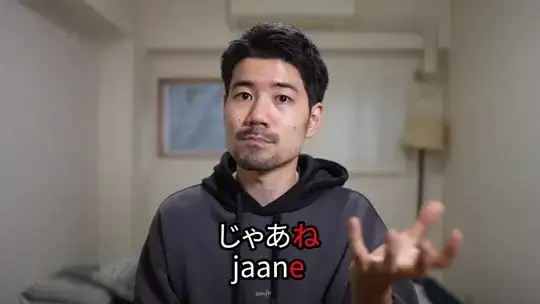

That Japanese Man Yuta seems to say じゃあね (jaa ne) is actually LESS formal / MORE casual compared to じゃあ.
  1. Btw, is the n supposed to be in red too?
  2. What's up with that MORE syllables are actually LESS formal / MORE casual? What are other examples of this?

The answer to your sub question 1 is yes. The ne at the end should be red, not just e. I'm sure it was just overlooked.
Yes; editing for these kinds of videos has minor slip-ups like that all the time.
