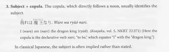

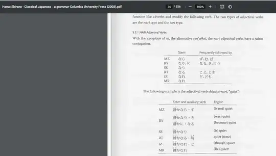

  • @Foogod I don't particularly consider anything. I was just indirectly quoting the book "Classical Japanese: A grammar" by Haruo Shirane. Since grammar is just something to classify meanings, I get why some linguist would call な a particle simply because it's simpler to view it that way specially when teaching Japanese to foreigners. Imo, the origin and evolution of the copula seemed really clear in the book but I get why people would classify It differently. That's why I don't think it's safe calling 綺麗だ 基本形 because it might be 終止形 and not 基本形 depending on the point of view. – Manab Dec 05 '22 at 20:15

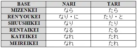

NA adjectives are nouns that have Chinese origin in general and started being used as adjectives. In classical Japanese there were two kinds òf adjectives. Some used to take the copula たり and some なり. The 連体形 of なり is なる. Therefore 静かなる部屋 became 静かな部屋. The old 連体形 of たり, たる is still used nowadays in modern Japanese. Example: 堂々たる態度. 好きだ is the predicative form that comes in the end 終止形. 好きな is the 連体形 because it has the 連体形 of the old copula なり. 好き is the 辞書形/語幹. enter image description here
