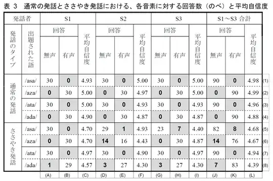

- 平岡睦津乃. 日本語のささやき発話における子音有声性の判別 (recent extensive article in Japanese, PDF)
This is the result of a listening experiment with 3 speakers and 15 listeners. The table shows whispered voiced consonants (ささやき発話) can be discriminated with slightly lower accuracy than in ordinary speech.
