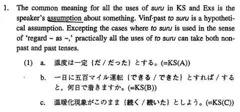

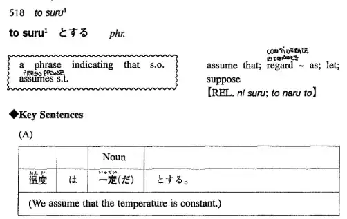

As the comment points out, this is the compound particle として, meaning something like "assume". Here is the entry given by A Dictionary of Intermediate Japanese Grammar, page 518:
Page 519:
So here it means something like "to take the speech and conduct or other things as the truth and accept it"
