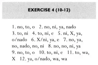

Instructions:
Question:
Book answer:
My answer:
歴史の本やドイツ語の辞書Xは机の上にあります。
I don't think など is compulsory, yet the book answer makes it seem as it were the case. To reach this conclusion, I just looked up a similar sentence from another book:
私は歌舞伎や能は観ません。
If は wasn't there, then など is required, right?
歴史の本やドイツ語の辞書など机の上にあります
