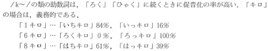

However, @a20 has found a paper titled "Morphology of numerical expressions in contemporary Japanese", where the pronunciation of numbers plus counters in written in kana and you can find the following:
Also interesting is the following:
which says that for 6 and 100 (which end in く), gemination essentially always occurs, but for 1 and 8 (which end in ち), there is some variation.

    Logically that makes sense. Googling also agrees, I found one result when using the Katakana version, but a lot when using the Hiragana version. I even found some article from Nara University which had this particular word as an example, among other interesting things: 現代日本語の数詞と助数詞 ー形態の整理と実態調査 http://repo.nara-u.ac.jp/modules/xoonips/download.php/AN00181569-19900300-1015.pdf?file_id=3658 – a20 Oct 04 '21 at 08:40
