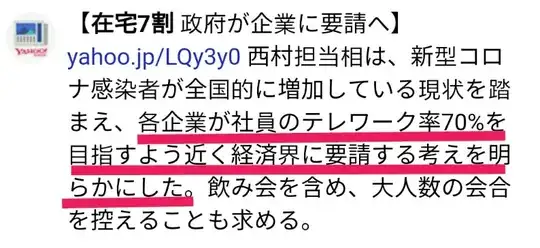

I saw this tweet earlier today. I find it difficult to understand the underlined portion. This is the first time I saw 目指すよう without に or な following it. The same goes with 近く. It looks like an adverb, but I'm sure it's not modifying 要請する. Is it 近くの with の omitted? This is not a newspaper headline, but what's with the omission of に and の?

  • Thanks for cropping the image naruto. (Apparently, the image is much larger than my cellphone screen) Did you have to download and reupload it just to crop it? – rebuuilt Jul 27 '20 at 00:17
    Yes, I just made another (partial) screenshot from your image and uploaded it. – naruto Jul 27 '20 at 00:18

This 近く is an adverb on its own (my dictionary says so). 近くの経済界 would mean "nearby world of economics", which makes little sense. 多く also has a special adverbial usage ("often", "mainly").

    Thanks! I just checked what 近く means and I didn't know that it can mean "soon", similar to but not replaceable by すぐに – rebuuilt Jul 27 '20 at 02:07
