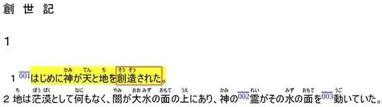

(The 2017 ed. of the Shinkaiyaku is not in the public domain, so the following is a screenshot from my purchased electronic version.)
Genesis 1:1–3, Shinkaiyaku Bible, ©2017
To clarify my question:
Most English translations have “God created...” “Created” is a simple past tense verb in English. In Japanese, 造りました (tsukurimashita) is the polite past indicative conjugation of 造​る. In my head, this seems like a relatively straightforward translation of “[he] created.”
When I look up 創造された, if I am not mistaken, it is composed of 創​造 (which may be a noun or suru verb), and [去​]{さ}れ​た, which again, if I am not mistaken, is the passive plain past indicative conjugation of する.
Why does the Shinkaiyaku translation use a verb conjugated in the passive voice? I admit I may simply be ignorant of a fundamental aspect of Japanese verb conjugations.

    Nah, it's not 去れた... The された (される) is the honorific (尊敬) form of した (する), the verb "to do". – chocolate Nov 04 '19 at 01:21

された in your example is the past form of される, which is an honorific form of する.
The auxiliary れる/られる can express 受け身 (passive), 尊敬 (honorific), 可能 (potential), and 自発 (spontaneous). For more on these usages:
創造された here is the past tense form of 創造される, which is an honorific form of 創造する.
聖書 tends to use more formal/literary language, while リビングバイブル, 日常語 (daily, everyday language). So 聖書 uses the kango 創造する, and リビングバイブル, the wago 造る.
