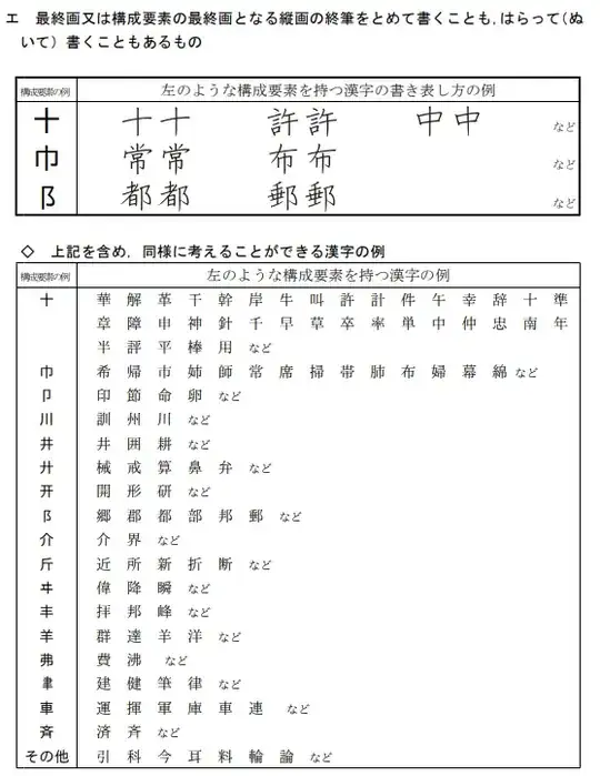

A recent guideline from 文化庁 clearly says this distinction is not important in most cases. See page 53 of this PDF (常用漢字表の字体・字形に関する指針(報告)(案)) (2016):
As for 木, you can also use はね (example).
Some recent elementary school teachers are extremely strict on this kind of thing, which has caused much controversy. Outside school, very few adults care about this. If you want examples for practice, find some 教科書体 font.
(The guideline above is for the general public. Professional calligraphers and historians may have their own opinions.)
