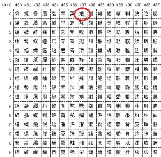

Not to take away from the general idea of the other answers, but those protrusions on the bottom end of「唱」are not serifs.
Noto sans CJK, a sans-serif font - sans-serif means without serifs.
These protrusions have been present since one-pixel wide bitmap fonts - I presume their purpose is to enhance legibility.
The font displayed in the question is classed as an East Asian Gothic typeface. In general, Ming typeface and its derivatives like Gothic typeface are unsuitable for handwriting imitation. Please see Is there an "official" font or other writing standard that should be used when teaching kanji? and make use of handwriting previews if you want to copy a style resembling handwriting.
