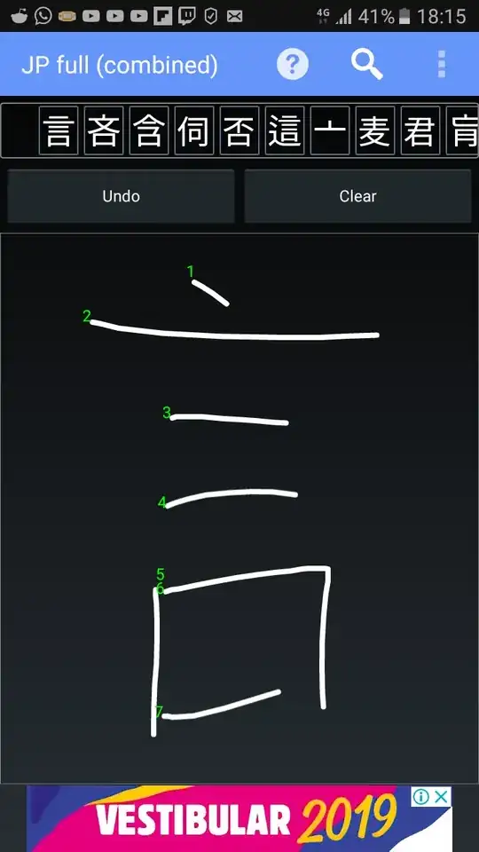

言's first stroke is different in handwriting and in computer code, mainly because it is more recognizeble in lower resolutions as a horizontal line.
When you are handwriting, you should draw the first stroke like shown in the picture, as a diagonal line:
notice that the app recognized the kanji
Notice that in most digital media, the word kanji(言)'s first stroke is a horizontal line
