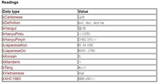

CJK unified ideographs are sorted based on radicals, not readings. This is because it's impossible to determine the reading of those characters in one way. The Unicode Consortium provides Unihan Database, which can display the representative readings of CJK ideographs written in simple Latin alphabet. For example, here is the result for a very basic ideograph 日 (U+65E5; "day", "date", "sun", etc):
Readings of 日
The table says the "first roman letter of 日" is J in Cantonese, R in Mandarin, H-or-K-or-N-or-J in Japanese and I in Korean. To understand what's going on here, please keep in mind that the 'CJK Unified Ideographs' block has characters used in Chinese, Korean and Japanese jumbled together. Each character is read differently in different languages. Especially in Japanese, one character can have many readings depending on the context. To make matters worse, there are some characters whose readings are totally unknown. If you can accept all those limitations and still want the Latin readings anyway, go ahead and use the database according to your needs. If you're only interested in Japanese kanji, a reasonable method would be to pick the first letter of the kJapaneseOn field (or the first letter of kJapaneseKun if there is no kJapaneseOn).

    This is a huge step forward to me - thru Unihan_Readings.txt in http://www.unicode.org/Public/UCD/latest/ucd/Unihan.zip I now have something to start automation with, despite being CJK (and more). Great! – AmigoJack Nov 08 '18 at 13:25
