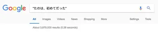

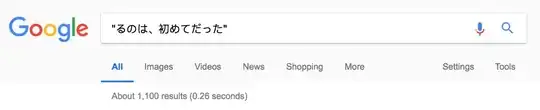

I did the following two Google searches:
Looks like it's more favored to say:
トムさんに話しかけられたのは、初めてだった。
than to say:
トムさんに話しかけられるのは、初めてだった。

Ethan Chen
  • 141
    The numbers appear to say that one is more than 3000 times as common as the other one (approximate ratio of 3000:1). This appears to be very distorted — the ratio is probably closer to 1.25:1 (or 1:0.8). – Earthliŋ Sep 26 '18 at 12:42
  • @Earthliŋ You're right. る is not the only type of verb endings. – Ethan Chen Oct 05 '18 at 14:25
  • The main problem is that Google counts are not accurate. – Earthliŋ Oct 05 '18 at 17:22
