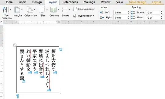

Two options for transcribing a handwritten source text with kunojiten into a typescript are:
  1. as JAM's answer suggests, use /\ and /″\ when typing horizontally 摂州大物の浦よしつねしう/″\難風に出合て平家のぼうれい御船を覆さんとする圖
  2. use 〳 and 〵, or 〴 and 〵 placed directly above each other when typing vertically. This works well in a Microsoft Word doc (create a one cell table, and change text direction). As soon as 〴 and 〵 are typed in they form a double-character length 〲.
vertical script with a kunojiten
This example (above) doesn't account for the furigana, but it's indicative. Original text below:
