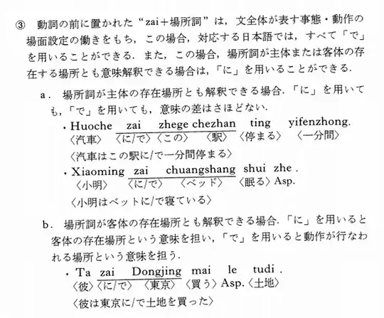

From the "377" page,
王欣や、増岡、田岡の説をまとめると話し手が場所に重点をおくと「に」が用いられ、動作の種類に重点をおくと「で」が用いられるとの事である。しかし、この説明はあまりすっきりしない感がある。以下にあげる➂の筆者のような説明のほうが理解しやすいのではないだろうか?
Summarizing the opinions by 王欣、増岡、田岡、when speaker put the weight on the very "location に is used, while when the speaker put the weight on the verb types, で is used. However, in my opinion, I am not so satisfied with their explanation. Would my view ➂ instead by me be more easy for readers to understand?
Therefore we go consequently her view ➂. I am sorry in my PC there is no software that can control the PDF.
*They are analyzing in connection with Chinese here.
Zai(in Chinese 在) +the place adjunct prior to the verb denotes overall location the whole sentence expresses within its incidents, action. The corresponding Japanese, in this case, can be expressed by で. Also, should the place adjunct be recognized as either subjective-objective location, に can be used.
a. When the place adjunct be interpreted as the location where the Subject ( the speaker ) is, either に or で can be used.
*I would like to abbreviate Chinese explanation since I am not well in Chinese.

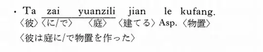

b. Should the place adjunct be interpreted as the location of the object, then に fits nicely to denote its object's location, whereas で is used in this case, it will denote the location where the subject will act.
