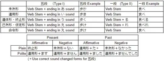

For verbs, their politeness conjugation uses the helper verb ます. The conjugation scheme is as follows: Verb Conjugation

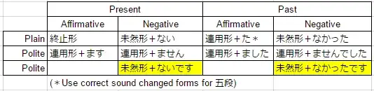

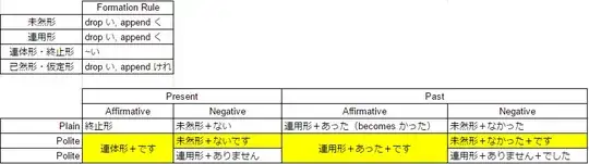

You may be slightly confused with the い-adjective conjugation scheme, which can use です as its politeness helper highlighted in yellow below:
i-adj conjugation
As a result you see that there are two negative polite forms. So for example you can have 暑くないです・暑くありません and their past forms 暑くなかったです・暑くありませんでした where we note that でした accounts for past tense and ません has already accounted for politeness in 暑くありませんでした.
Now to complete the earlier table for verbs, we note that ない is syntactically a い-adjective and obeys the conjugation rules for い-adjectives. So now for verbs we have:
Completed Verb Conjugation Table
This is why you see 上げられないです, but you cannot get 来られますです or 来られるです.
