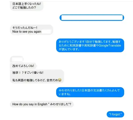

I was speaking with a friend of mine and said I learnt Japanese using some dictionaries and websites. But I forgot to mention that I also use grammar books, so I said:
忘れてた!日本語の文法書たくさんよんでいますね。
I forgot! I read many Japanese grammar books.

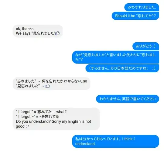

She then corrected me saying it should be 見忘れました instead, hinting that with 忘れてた (or 忘れました) you can't drop what was forgotten (i.e. it needs to be explicitly said e.g.
〜を忘れてた
I forgot .
Does the 見 at the start of the verb make the transitive verb (requiring an object) into an intransitive verb (not requiring an object)?

EDIT: Full conversation below (please ignore spelling mistake of 見忘れました as みわせれりました
Conversation screen grab part a Conversation screen grab part b

  • Her response: "忘れました" → 何を忘れたかわからない。so "見忘れました" → -thumbs up- Also: " I forgot " = 忘れてた→ what? " I forgot ~" = ~を忘れてた – crimsonspectre Apr 25 '16 at 11:15
    Seems to me that there are already some misunderstandings before the sentences. Did you put translation together with every your line? (It was chat, right?) – broccoli forest Apr 25 '16 at 17:41

I think the reason they corrected you to say 見忘れました was that you typed みわせれりました which looked/sounded like みわすれました; as I said in the comment, 見忘れました(I forgot to see) wouldn't make sense there.
And they said 「忘れました→何を忘れたかわからない。見忘れました→👍」(by which I think they meant to say: "If you just said 忘れました, I wouldn't know what you forgot. So I recommend you say 見忘れました"), and 「忘れてた→what? "I forgot~~" = ~を忘れてた」(by which I think they meant: "If you just said 忘れてた, I'd want to ask 'What did you forget?' so I recommend you say like XXを忘れてた(I forgot + [an object])")...
But, in real life, we often use the phrase 「あっ、忘れた!/ 忘れました!/ 忘れちゃった!etc.」(I forgot!) or 「あっ、忘れてた!/ 忘れてました!」(I had forgotten! / Now I remembered!) without explicitly mentioning what you forgot or forgot to do, so...
