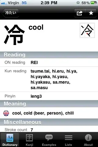

The screenshot below is from Kotoba for iPhone.
tsumetai
It shows the character for "cool", 冷 as used in the word 冷たい. However, the character in the stroke order diagram is slightly different to the main one displayed top-left!
Why is this? Which one is correct? Or are both correct?
I suspect the stroke order diagram actually comes from a Chinese font, rather than a Japanese font. I'd like to confirm this.

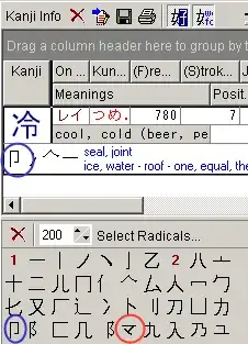

Thanks to Lukman for the following screenshot:
different radicals

    マ is not even a radical, though, strictly speaking. It looks to me like that program is using the word "radical" in a very broad sense, roughly meaning "oft-encountered visual element", to make it easier to find characters. WWWJDIC and its descendants do the same thing for their kanji search, sometimes referring to these as "parts" or "elements" to distinguish them from radicals. This is convenient because it means you can find 予 without knowing that its radical is actually 亅, but it muddies the waters when you actually want to discuss radicals as traditionally defined. – Matt Sep 20 '11 at 07:19

    @Matt: Kotoba (the program above) and about 99% of all Japanese-learning software out there all use the same WWWJDIC dataset. So you can expect the same mistake/idiosyncrasies. Your point is interesting (I did not know that WWWJDIC's set of "radicals" differed from, say standard dictionary bushu), but I also think convenience is by far the priority for such a tool... – Dave Sep 20 '11 at 13:48
  • @MatthewD: the hand-drawn animation comes from a dedicated open-source project called KanjiVG: built with a Japanese public in mind. – Dave Sep 20 '11 at 13:49
    @Dave For sure! I won't deny that I make good use of the "element" search at www.jisho.org myself. Just pointing out that since マ isn't a "real" radical, it's not quite correct to say that the two forms "use different radicals." – Matt Sep 20 '11 at 14:02
  • @Matt: definitely. If anything, WWWJDIC's radical lists for a lot of kanji show multiple redundant breakdowns, using different "radicals" etc. – Dave Sep 20 '11 at 15:52
  • @Dave: Thanks for the info about KanjiVG. Check out their Incorrect Kanji page though, which lists 令 under the heading "The following kanji need to be checked and validated or fixed". – MatthewD Sep 21 '11 at 03:30
  • @MatthewD: this is a wiki and can be edited by anybody. The comment attached to the entry asks essentially the same thing as you did and is in no way authoritative. – Dave Sep 21 '11 at 05:11
  • @Matt: To be honest, I can hardly imagine any other definition of 'radical' in the context of kanji than "oft-encountered visual element", let alone one that would be more useful in any common context... please explain? – Karl Knechtel Sep 23 '11 at 20:08
  • @Karl Knechtel - The word is often used loosely in the way you describe, but strictly speaking, it's a translation of "部首", a more closely defined classifying component of individual kanji. http://japanese.about.com/library/weekly/aa070101a.htm – rdb Sep 24 '11 at 02:31

It's no big deal, just that the most common standard handwritten form of the character is different from the most common printed form of the character. This doesn't even rise to the level of "variant character" in the strictest sense (like 悪 vs 惡). The two are the same character, just like a joined-up printed さ is the same as a disjoint handwritten one, or a cursive [a] is the same as a printed one in English.
The Chinese/Japanese thing is a red herring: here are two more sources clearly aimed at Japanese people showing this handwritten form. It is true that the printed Chinese form looks more like the diagram, but this is just because the "official" printed Chinese form was revised to be more in line with the pre-existing standard written form, shared by both Japanese and Chinese.
If you won't take my word for the above, check out the jōyō kanji guidelines [PDF] from the Ministry of Education. Scroll down to the section headed "明朝体と筆写の楷書との関係について" and you will see many similar cases of difference between standard printed and written forms, along with the Ministry formally declaring that these differences do not result in "different characters", or that the written form is "wrong". ("... 筆写の楷書における書き方の習慣を改めようとするものではない。 ... 印刷文字と手書き文字におけるそれぞれの習慣の相違に基づく表現の差と見るべきものである。")
Note that the character 令 is actually one of the examples in their "筆写の楷書では,いろいろな書き方があるもの" section, and the form with a final vertical is recognized as a possible "correct" handwritten version, so if it makes you feel more comfortable, go for it! Just don't be ragging on people who write it diagonally, because that's cool too.
