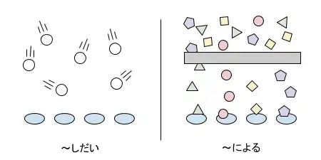

There are many ways to describe the difference between them. Let me give a picture first.
X 次第 could be explained like "depending on how X acts/becomes", or typically the cause-effect relationship is unknown, or by chance, or the result that is brought about is not clear from the first impression of X or hard to explain beforehand, or the event causer has free will so that you couldn't know before the next move, and so on.
Meanwhile, X による could be explained like "depending on what X falls under", implying each type of X automatically evokes each result, or you already have roughly grasped the rule of correspondence between X and what happens, or you can easily recognize the nature of X or classify what kind of X it is, and so on.
Of course, in most ordinary situations, the two can be used interchangeably because things are often multi-faceted; they could hardly be as different as he hit you in the jaw with his fist or you hit him in the fist with your jaw. But sometimes you cannot swap them:
