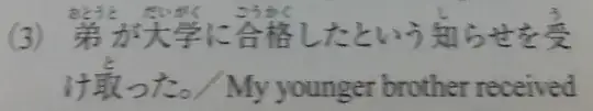

However, today I found almost the same sentence quoted from
A Handbook of Japanese Grammar Patterns for Teachers and Leaners on page 317-318,
as follows.
Its translation is apparently contrary to the analysis given in the existing answers. I am now in a critical position but committing suicide is not my option.

    @優しいエイリアン What's already said in my answer still applies for this (3). "弟が合格した" modifies 知らせ, and this 弟 is not the topic of the whole sentence. The subject of 受け取った (i.e., who received the notice) is omitted. It may be 弟 or someone else who received the notice. It's very unlikely that this sentence means "弟 received the notice that someone else passed the entrance exam." – naruto Jun 14 '16 at 07:37
