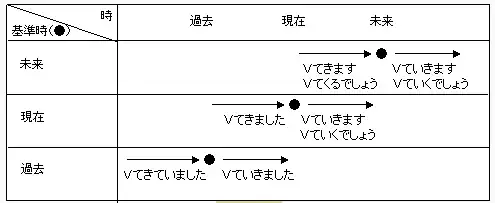

According to this page by 東京外国語大学, the difference between 「Vていった」 and 「Vてきた」 mainly rests on the positioning of the reference point on the time axis:
I guess the concern of the heroine, who uttered that line, was on the flowers in her hands at that moment. Then why didn't she choose NOW as the reference point and say 「お花しおれてきちゃった」 instead?
