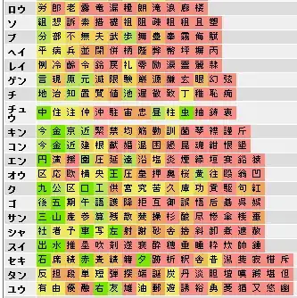

If you prefer visuals I've done some research on this topic several years ago. Like, for example, this is the list of kanji grouped by ON-yomi and sorted by their uniqueness.
list of ON-yomi usage by different kanji
The research was done for most popular kanji learned in school (1945 total). Here are some interesting results I got:
  1. List of kanji grouped by number of different ON-yomi they have
    • 1460 kanji have single ON-yomi
    • 401 kanji have 2 different ON-yomi
    • 63 kanji have 3 different ON-yomi
    • 11 kanji have 4 different ON-yomi
    • 5 kanji have 5 different ON-yomi
    • 5 kanji don't have ON-yomi (込, 枠, 畑, 峠, 匁)
    • 375 kanji don't have KUN-yomi
    • 5 most popular readings are: ショウ (77 characters have it!), コウ, シ, カン, トウ...
    • total number of different ON readings is 323 (direct answer to your question :) )
  2. List of kanji grouped by ON-yomi and sorted by ON-yomi uniqueness (kanji inside each row are sorted by ascending school grade)
  3. List of kanji grouped by ON-yomi and sorted by ON-yomi uniqueness (kanji inside each row are sorted by descending usage frequency)
The colors represent school grade (from green to red: Grade 1, Grade 2... Grade 6, Middle/High-School).
The research helped me to find out many useful things, such as that there are many characters which have single and unique ON-yomi. Knowing that makes it much easier to remember.
Hope you'll find it useful too.
PS. To make the research I used JMDict data.
PPS. Some parts of the pages are in Russian, sorry about that.

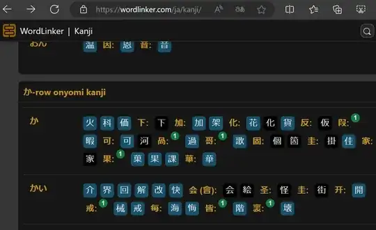

Although not all kanji's [音読み]{onyomi}, the website wordlinker.com lists all JLPT kanji's onyomi. Their data comes from the JMdict dictionary files.
The site lists exactly 311 different onyomi, and it groups kanji sharing the same phonetic component to help you memorize them (most kanji have a component that determines their reading).
Below is a sample from the page:
Kanji list classified by onyomi
Kanjis that have only one onyomi are listed in blue, which is helpful to memorize their readings.
