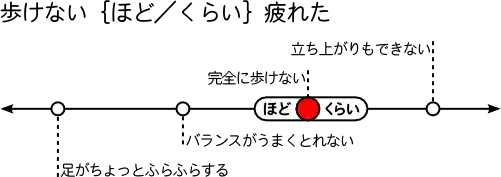

Let's look at 歩けない { ほど/くらい } 疲れた. Diagrammed, it looks like this:
Comparison of hodo and kurai
Both ほど and くらい express the level of tiredness marked by the red dot (not being able to walk at all). But ほど focuses on the left side of that dot, and it emphasizes the fact that the level of fatigue exceeds both the level where your legs get a little wobbly (first dot) and the level where you can't keep your balance well (second dot). But ほど does not exceed the red dot.
With くらい, on the other hand, the scale starts at the red dot, and may even go higher to the last dot (not even being able to stand up). The surprise expressed by ほど is mostly absent, and the sentence is more along the lines of a simple statement of fact.

The common thread running through these sentences is that the level marked by ほど is not reached. (All of the sentences could be reordered to fit the pattern "B may be true, but not to the extent A.") In other words, the actual level lies to the left of the red dot on the above diagram. Because it's on the left side, only ほど can be used.

In all of these sentences, くらい (sometimes ぐらい; the difference was covered in this question) marks a minimum level. So now we're dealing with the portion of the diagram to the right of the red dot. Thus, only くらい is allowed.

In statements like these, ほど, because it covers the left end of the scale, implies that you haven't reached the red dot yet, but it feels like you're getting close. くらい is different. With くらい, you're at the red dot and are on the way to more extreme levels (toward the right end of the scale). 死ぬくらい thus conveys more immediacy and reality than 死ぬほど, which can be used "lightly" and without really meaning it.
