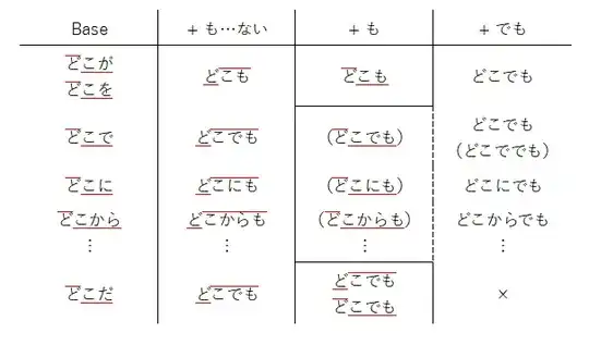

To clear up the situation:
  1. In the first place, どこ is grammatically a noun "what place" in Japanese, thus is always accompanied by particles when it appears in a sentence. This applies to all question words except どんな (adjective) and どう (adverb).
  2. There are three series of 取り立て助詞 ("focus particle") that are involved in this question. 取り立て助詞 usually attach to another particle from behind, except when が or を comes before, then they'll eat it.
    • も (with negative verb)
      It works like English "not ... any X", "no X" if attaches to a question word. Combined with どこ, "not [preposition] any place" or "[preposition] nowhere". The accent pattern of phrase always be accentless (no pitch downstep within the phrase).
    • も (without negative verb)
      Works like "every X" with a question word. Combined with どこ, "[preposition] every place" or "[preposition] everywhere". The accent pattern is that of the base noun (i.e. follows どこ{HL}).
    • でも
      Works like "any X" with a question word. Combined with どこ, "[preposition] any place" or "anywhere". The accent pattern is usually accentless, but when you put emphasis on this phrase, the accent of the base noun is restored. Note that since this particle is originated from だ + も, therefore you can't attach it after だ once again.
    • ~も vs ~でも
      We disproportionately prefer "どこ + particle + でも" to "どこ + particle + も" (positive). I've only heard this positive も series used in "every X ... each Y" construction. The same seems to apply to all question words.
      どこにも{HLLL}住んでみなければわからない苦労がある。
      Every place has its own troubles of life you'll never know until you live there.
  3. As you can see, the form どこも appears in two slots, and どこでも confusingly enough takes up six slots(!). Let's summarize them.
    • どこも
      • (not) any place (subject/object): どこが/を + も(neg.) [どこも{LHH}]
      • every place (subject/object): どこが/を + も(pos.) [どこも{HLL}]
    • どこでも
      • any place (subject/object): どこが/を + でも [どこでも{LHHH}, どこでも{HLLL}]
      • (not) at/in any place: どこ + で + も(neg.) [どこでも{LHHH}]
      • at/in every place: どこ + で + も(pos.) [どこでも{HLLL}] (infrequent)
      • at/in any place: どこ + で + でも [どこでも{LHHH}, どこでも{HLLL}]
      • be (not) any place, be (not) anywhere: どこ + だ + も(neg.) [どこでも{LHHH}]
      • be every/any place, be every/any-where: どこ + だ + も(pos.) [どこでも{LHHH}, どこでも{HLLL}]
    • どこにでも
      • to/at any place: どこ + に + でも [どこにでも{LHHHH}, どこにでも{HLLLL}]
