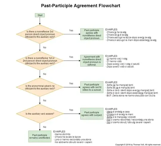

I thought the participle doesn't agree with object when the auxiliary verb is 'avere'.
This only applies when the direct object isn’t a clitic pronoun attached to the auxiliary. I have made a flowchart that explains the process:
Tom S. Fox
  • 270
    Your flowchart is interesting, but I'm not sure if, in your examples, "ne" can be called "adverb". Maybe it would be better to call it "pronominal particle". – Charo Sep 23 '18 at 19:21
  • Anyway, the final sentence of your chart maybe should be something like "In modern Italian, past participle usually remains uninflected" because of this kind of issues. – Charo Sep 23 '18 at 22:04
    This flowchart looks unnecessarily complex: it inspires awe rather than clarifying a matter that can be explained with a couple of sentences (and I'm a mathematician, I love flowcharts per se). – DaG Sep 23 '18 at 22:36
  • @DaG: If you have suggestions on how to simplify the chart, feel free to tell me. – Tom S. Fox Sep 24 '18 at 02:15
  • Tom, when several native speakers, some of them who have studied more than a bit of grammar, tell you that ne in this case is a pronominal particle and give you references, you should probably listen (It is true that ne and ci can also be adverbs, e.g. in Ne partii la mattina presto, words are allowed to have more than one meaning, but not in this context). I suggest you ask it as a separate question. I'm moving the discussion to chat. – Denis Nardin Sep 24 '18 at 07:15
