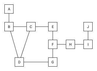

Nobody can count the amount of full nodes
(Because of that, there are also no sites that track them)
Why?
Full Nodes
Every square is a full node. Connected nodes are neighbours.
  • F has 3 Neighbours: E, H and G.
  • F knows is that there are at least 4 nodes in the network.
  • F does not know how many or which neighbours E, H or G have.
  • F has no idea that J or C or D even exist
That's why you can't and never will be able to count the full nodes in the system.
