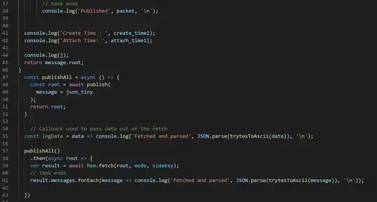

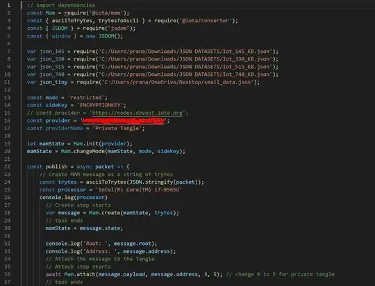

I know MAM is deprecated but I am doing some research on MAM. I was able to send and fetch a data payload of size 740 KB. But when I tried to use a data of 1 MB I am getting this issue with node.js
Node.js displays fatal runtime error: Allocator memory exhausted trap! trap!
I even tried to increase the --max-old-space parameter but it did not work. I am using JSON datasets and a private tangle of 3 nodes.
Will splitting the data into fragments work? If so, then how do I do that and send them to the tangle using MAM?
Please help someone. I have attached images of my MAM code here.enter image description hereenter image description here

Splitting the data into fragments will work. Alternatively if you work with the IOTA streams library you should have more luck with big sizes.
https://github.com/iotaledger/streams
