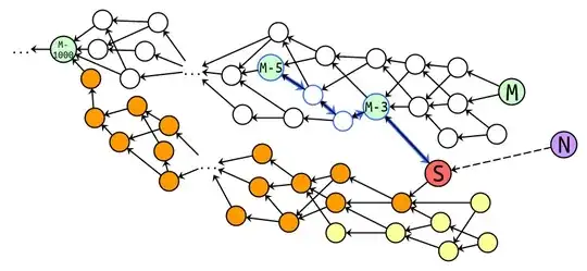

Assume that the current milestone is M and the side tangle has been forked off milestone M-1000. Also, assume that there is a transaction (we'll call it stitching transaction) which approves both a recent transaction of the side tangle (e.g. 1000 transactions after the last milestone) - let's call that transaction S - and the milestone M-3.
When now starting a random walk [blue] at depth 5 [M-5], it may (does not have to) end up at milestone M-3. From there, there is a certain chance that it continues walking to the stitching transaction S. As soon as this happens, the node has to validate that this transaction is indeed valid. Therefore, its both approved transactions have to be validated. Validating M-3 is simple (it's a milestone), but validating S takes a long time, since most of the side tangle [orange] needs to be validated.
The current fix prevents that such transactions S or the stitching transaction get chosen by the random walk (because the milestone approved by them is M-1000 and therefore too old).

  • Is this the scenario you described @mihi? May I add the picture to your answer? – Zauz Jul 26 '18 at 22:29
  • @Zauz pedantic people might notice that there have to be at least two other nodes (milestones) on the path between M and M-3 (being M-1 and M-2), but apart from that it looks fine to me (perhaps you can add M-4 between M-3 and M-5 as well).
    Since this is stackoverflow, feel free to edit my answers with your illustrations. :)
    – mihi Jul 27 '18 at 20:48
    @Zauz perhaps it is also a good idea to color the transactions of the side tangle that are not (indirectly) approved by S in a slightly different shade of yellow (to emphasize which transactions have to be validated) – mihi Jul 27 '18 at 20:51
  • Is a depth 5 random walk starting at M-5 or M-4? – Zauz Jul 27 '18 at 21:07
  • I did not test it, but the source code looks like it passes M-6 to findClosestNextMilestone, which in turn will search for a number strictly greater than M-6 and therefore find M-5. – mihi Jul 27 '18 at 21:47
  • Aren’t the blue arrows pointing into the wrong direction if they are meant to illustrate the walk? – ralf Jul 29 '18 at 08:20
