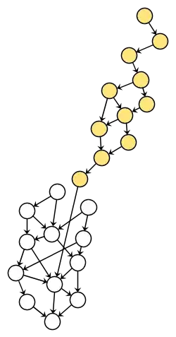

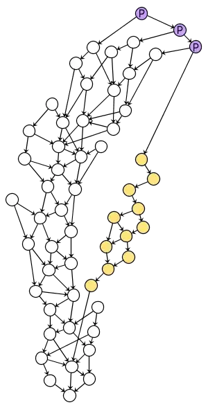

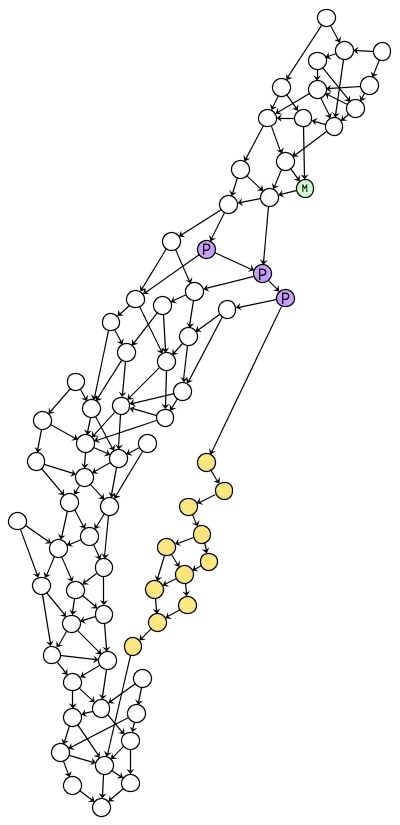

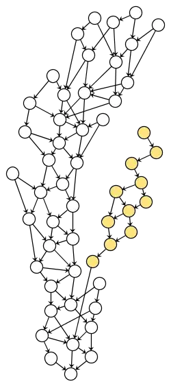

This is our main tangle:
When you start a subtangle you are going offline. You no longer know which new transactions other people/devices make and other people/devices no longer know which new transactions you make. But the tangle you stored when you still were online will remain in your memory.
You should start your subtangle at a transaction that has already been validated by a lot of transactions or today, with the COO, at a milestone or transaction validated by a milestone.
Then you just stay offline and make some transactions. (You don't need to be the only node. It also works if e.g. 3 nodes are connected to each other but disconnected from the rest of the network)
The proof of work is done when you attach the transaction to your subtangle.
When you want to reconnect, you broadcast all transactions in the subtangle to the network.
If you have been offline for a long time, it is very unlikely that your transaction will be confirmed because the tip selection algorithm favours new transactions. Your transactions, regardless of when you made them, "look" very old to the algorithm because the connection to the main tangle is very old.
So if you want your subtangle to be confirmed, you have to promote it, just like unconfirmed transactions with the wallet.
Eventually one of the transactions referencing your subtangle will be confirmed by the majority of new transactions or a milestone.
