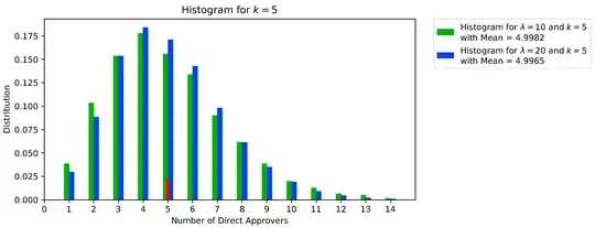

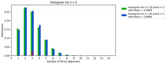

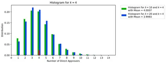

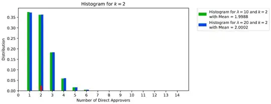

Let us assume every transaction directly references exactly k other transactions (k = 2 in the case of IOTA). Now under uniform random tip selection, every transaction will on average be referenced by k other transactions (due to the stationarity property).
The histograms below provide a visual proof of this. I assumed a network delay of h = 1 with 40k transactions per simulation. For comparison purposes, I am including two examples for the issue-rate λ (10 and 20).
Histogram for k=2 Histogram for k=3 Histogram for k=4 Histogram for k=5
