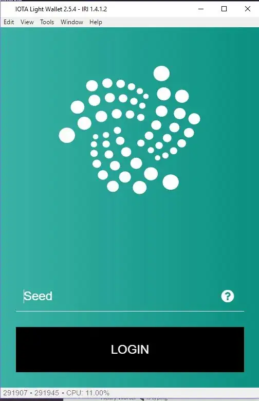

Download the Iota Wallet for Desktop from -> https://github.com/iotaledger/wallet/releases
Get the "IOTA.Wallet.Setup.2.5.4.exe" (or newer)
After you install it this is what you see. In the "SEED" field enter your generated seed and click login. Yo are done.
Careful: In order to see if you didn't make a typo on your seed note the last three characters (checksum) where the "?" is. Enter the seed again and make sure that the checksum is identical.

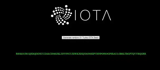

Create the seed with javascript (and/or offline):
Create the index.html and run in the browser of your choice.
