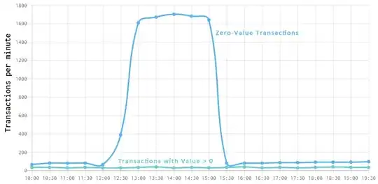

It is worth noting that it is indeed possible to spam the network (to some degree), because the PoW is fairly small. So there have been instances in the past where people tried to flood the network with transactions. See e.g.
(taken as of 05-Dec-2017 from http://iota.dance/tangle)
