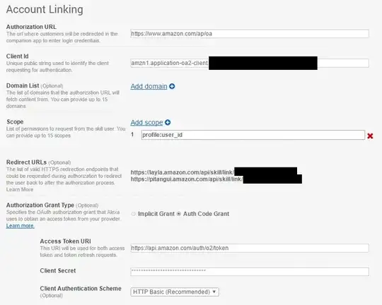

I created an Alexa Smart Home Skill to go enhance my home automation setup. The goal is to look into voice controlling my Raspberry Pi via Alexa. To do so I followed this Amazon developer blog to reach the mandatory account linking between the Alexa skill and an authentication provider. In this case this provider is Login with Amazon (LWA).
However following the instructions and using the skills redirection URL starting with https://pitangui.amazon.com/api/skill/link/.... proved to be utterly unsuccessful and just earned me a very non-descriptive error message. Essentially just saying that it didn't work. Great.
How do I make the LWA work with my Alexa skill?

After some fiddling around with the involved Amazon components I figured it out. The blog itself and its focus on what the URL starts with is actually rather unhelpful or even misleading. In fact the solution is annoyingly easy. All the provided URLs have to be entered as redirect-URLs, not just the pitangui URL that is mentioned in the blog. Apparently nowadays the skills offer more different redirect URLs that have to be added.
AlexaSkillAccountLinking
When both redirect URLs are entered into the security profile the authentication goes smoothly.

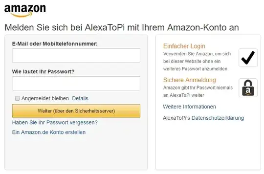

This screen allows us to authenticate oneself to the skill with the Amazon credentials. Problem solved. Now the security profile works and I have successfully activated my custom Alexa skill on my Echo.
