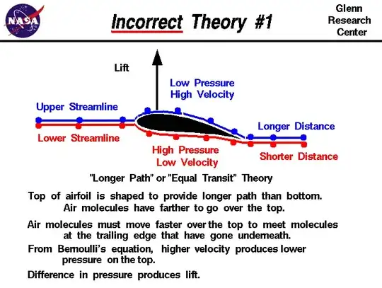

It's supposedly a "widely circulated" false claim that wings generate lift because of their asymmetric shape, forcing air above to travel faster so that they meet up on the trailing edge at the same time as air below, and by Bernoulli's equation, the pressure below the wing must therefore be higher.
Explanation (with diagram) of equal transit-time theory
Source: https://www.grc.nasa.gov/WWW/k-12/airplane/wrong1.html
I've only ever encountered this "equal transit-time" theory when it's being debunked, so it seems like its more common to see it pointed out as wrong rather than alleged to be true.
Was this incorrect theory ever a common misconception? And did this misconception originate from a particular source?

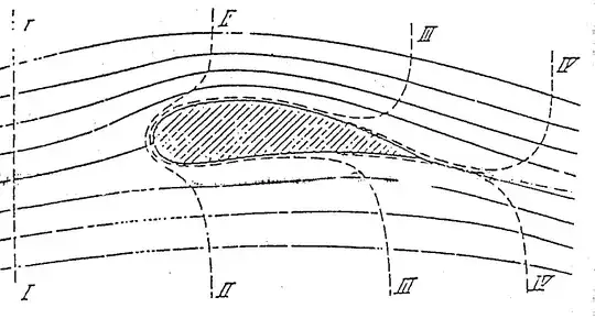

Klaus Weltner and Martin Ingelman-Sundberg (from the Department of Physics at the University Frankfurt) in an ultimately unpublished paper, “Physics of Flight — reviewed”, submitted to the European Journal of Physics in 2003, argue that the original source for the misconception of “equal transit time” was, somewhat unwittingly, aerodynamics pioneer Ludwig Prandtl circa 1922.
Their article leads with a summary of “Darstellung der Aerodynamik in Schulphysikbüchern”, a book published in 1989 by Klaus Niermann:
Niermann analyzed all German language textbooks published within the last one hundred years investigating the explanations of aerodynamic lift. The main result is that explanations based on Bernoulli’s law are dominating since the 1920s. He found the same to be true for a survey of contemporary American and English textbooks.
The authors eventually go on to conclude:
Thus the origin of the path length reasoning may be found in a diagram given by Prandtl in 1922.
diagram by Prandtl
With this diagram Prandtl tried to show that air at the inner layers stick to the surface. In respect to one point this diagram is not correct. It indicates that the volumes remain at the same vertical position and it indicates that originally adjacent air meets again at the end of the airfoil. […]
Diagrams of this type might have misled scholars to the hypothesis that adjacent air has to meet again after passing the airfoil.
The text says 1922, which may very well refer to the original German publication, though the actual reference the authors cite is the English translation, produced by the National Advisory Committee for Aeronautics, titled “Applications of Modern Hydrodynamics to Aeronautics” and published in 1923.
