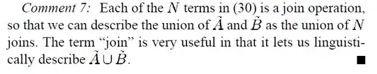

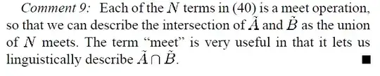

I did a quick survey on the origins of join and meet on Google books. Join and meet do not have German origins. See some early references. Ref: Information and Control 31, 312-340 (1976), Some Properties of Fuzzy Sets of Type 2 Masaharu Mizumoto & Kokichi Tanaka
join and meet
Another work rationalizes this terminology by Jerry M. Mendel and Robert I. Bob John (2002) enter image description here enter image description here
