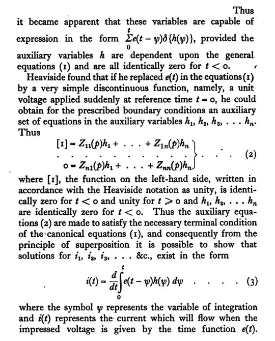

But a shorter indication of its logic-flow, as described in H J Josephs' commentary Heaviside's Electric Circuit Theory, may be of interest:
[Pages 6-10 in Josephs' monograph build up a set of canonical equations and formulae which]
... in concentrated form contains the whole theory of the symbolic solution [of the differential equations] of alternating-current problems. [But classical solution-methods give] only steady-state currents ... and such currents are 'forced' currents. They vary with the time in precisely the same manner as do the electromotive forces. Such currents are, however, only part of the total currents; the complete solution must contain transient as well as steady-states.
If it is found that the steady-state solution of a problem is sufficient, then the need for the use of the Heaviside calculus does not arise. In cases such as this the well-known symbolic method ... is sufficient.
[However, the classical methods usually break down in the attempted solution of the transient problem.]
It was at this point that Heaviside parted with classic analysis and invented his operational calculus ...
In his attack on the general problem Heaviside made use of the principle of superposition. When several electromotive forces are applied simultaneously to a network of fixed parameters, each produces its own effect independently of the others. Thus the effect of each alone may be calculated and the results added to obtain a resultant due to the simultaneous action of the various electromotive forces. This suggested to Heaviside that he could deduce a superposition theorem expressing the independent variables in terms of voltage and admittance functions which have been made to satisfy the necessary terminal conditions of the network.
[In the following description, the step-function mentioned in the question, denoted [ 1 ] below, is defined as identically zero for t<0 and identically 1 for t>=0.]
extract from Josephs (1946)
What remained was to determine the 'indicial admittance' functions h(t), which Heaviside did by solving 'operational equations' in which differential and integral operators are replaced by symbols $ p $ and $ p^(-1) $ , then treated as if algebraic.
