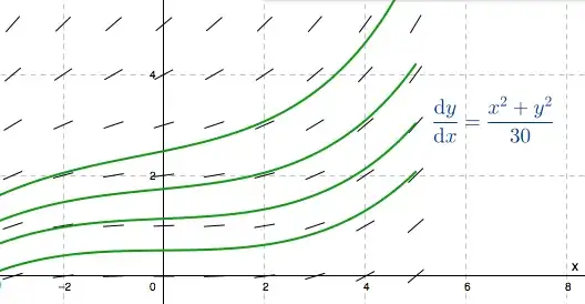

When first encountering slope fields in calculus or elementary differential equations, students often ask "What is the purpose?"
A concise answer is that slope fields provide a way to graphically represent a first-order ODE of the form y' = f(x, y). Graphical representations can provide a range of insights regarding the overall behavior of solutions, at a glance. The same cannot often be said about symbolic representations.

What is the earliest instance of a slope field as a graphical representation of the first-order differential equation y' = f(x, y)?
Here I refer not to the underlying idea of a slope field, but rather an actual picture, similar to what is now commonly found in introductory textbooks on elementary differential equations.
I would be happy to see any early examples, not necessarily the very earliest. I would also be happy to see early occurrences of the term "slope field" or "direction field," since these indicate the existence of actual pictures.

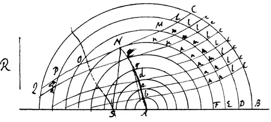

Johann Bernoulli explains the idea of a direction field quite explicitly (Modus generalis construendi omnes aequationes differentiales primi gradus, Acta Eruditorum, November 1694). He focusses on drawing isoclines rather than slope segments. There is no figure in that work but Bernoulli drew an example in his correspondence:
Corresponding to:
Dominique Tournès, Résolution graphique des équations différentielles, discusses this and many other historical examples.

    This is certainly a graphical representation of an ODE and a useful answer, but personally I'd shy away from calling Bernoullis "directrices" a slope field. But I have not read Bernoullis article you cite, so maybe he does indeed explain the slope field in words there. – Michael Bächtold Jan 30 '19 at 12:13
    @MichaelBächtold Yes. Very relevant - the article indicates that what we now call isoclines were introduced by Johann Bernoulli in 1694 and were applied by Van der Pol in his famous equation. However, it does not appear to treat slope fields directly. I still wonder when slope fields with segments originated or were popularized. If anyone can access the 1944 reference in my original post to put an upper bound on the introduction of slope fields, that would help (that article refers to a "direction field," but I haven't been able to access a full copy yet to see the figures). – Greg Stanton Jan 30 '19 at 13:02
    The curves in Bernoulli's figure are constructed by drawing line segments from one isocline circle to the next, the slopes of the segments being determined by the slope value associated with the isocline in question. So they function very much like a slope field and this is Bernoulli's reason for introducing them. The difference with a modern slope field is cosmetic in my opinion. – Viktor Blasjo Jan 30 '19 at 13:19
    From a modern perspective, once one has understood things, many differences seem cosmetic. I do think there is a genuine nontrivial step involved in passing from the directrices to slope fields. To make an analogy: the difference between visualising a function of two variables by a surface in 3d or representing it by isoclines in 2d might seem cosmetic, but I doubt if it was so obvious the first time people came up with these visualisations. – Michael Bächtold Jan 30 '19 at 14:13
