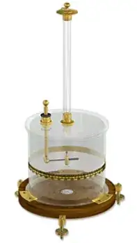

People did not. They generated and stored static electricity, but measuring it, other than by how strong the electic shock felt, was not yet done. Coulomb was the one who invented a way to do it in 1785. For this he used a device called torsion balance. John Michell used it earlier to measure gravity, but Coulomb re-invented the idea, and made it famous. Maglab.org has a picture and a description of how it worked:
"A narrow glass tube extends through the top of the glass case. At the top of the tube is a metal sphere, from which the needle hangs by the thread. A small metal sphere is at one end of the needle, which can swing freely due to its suspended state. Protruding through the top of the glass case is also a metal rod with metal spheres at both ends (one inside the case, one outside).
To use the torsion balance, Coulomb would hold an object near the metal sphere at the upper end of the metal rod. Any charge held by the object being studied would transfer to the metal sphere, then travel along the rod to the sphere at the other end. There the charge could affect the needle suspended in the case, which in its resting state touched the rod's lower sphere. So any charge in that sphere passed to the needle’s sphere. Once the rod’s sphere and the needle’s sphere both became similarly charged, they repelled one another. The repulsion caused the needle to move and the thread holding it to twist.
The twisting action is called torsion, hence the name of the instrument. To determine how much torsion occurred, Coulomb consulted a small scale marked in degrees near the upper end of the narrow glass tube. A second scale encircling the glass case itself allowed him to determine how far the needle moved. As Coulomb realized, the greater the charge, the greater the torsion and displacement he observed."
