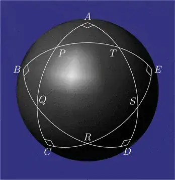

The Pentagramma Mirificum is a spherical figure formed by a series of five great circle arcs, each orthogonal to the next, and it probably does deserve a Wikipedia entry. However some elementary information about it is available online. A good start is Math Central where we read that
"The story begins in 1602, when Nathaniel Torporley (1564-1632) began to investigate the five "parts" a, A, b, B, c of a right-angled spherical triangle (right-angled at C). According to De Morgan, Torporley anticipated by a dozen years the famous rules of Napier which Gauss embodied in his pentagramma mirificum... The "core" of the pentagram is a pentagon whose vertices are (obviously) poles of these five arcs; it is thus a self-polar pentagon. [This means that if a vertex of the inside pentagon is placed at the north pole of the sphere, the opposite side lies along the equator.] The whole figure can be derived from the right-angled triangle ABC (appearing at the top) by extending the sides and drawing also the polar great circles of the vertices A and B."
Wikipedia does have an article on Napier's rules, which are a mnemonic for ten identities relating every triple chosen from the set a, b, c, A, B. The identities are algebraic when written in terms of their square tangents. If we call the arc lengths $L_i$ instead, and set $a_i=\tan^2 (L_i)$ then $a_ia_{i+1}=1+a_{i+3}$, adding the indices mod $5$.
Gauss noticed that the first three of these identities imply the other two, incidentally this proves the horizontal $5$-periodicity of the Coxeter's frieze pattern of width $2$. Coxeter's frieze patterns are arrengements of numbers into horizontal rows so that $2\times2$ determinants formed by neighboring four numbers are $1$. For an elementary exposition see the first lecture of Tabachnikov's Three Lectures on Frieze Patterns. For a more extensive survey see Coxeter's Frieze patterns at the Crossroads of Algebra, Geometry and Combinatorics by Morier-Genoud, where the pentagramma mirificum is also discussed. Frieze patterns lead into less elementary precincts. For those interested, the space of classical Coxeter’s frieze patterns can be presented as a discrete version of a coadjoint orbit of the Virasoro algebra, and the canonical cluster pre-symplectic form on it is a discretization of the Kirillov symplectic form, see Coxeter's Frieze Patterns and Discretization of the Virasoro Orbit by Ovsienko and Tabachnikov.
Another modern relation is to cluster algebras of Fomin and Zelevinsky, already covered by Wikipedia. The algebras are generated by subsets of fixed size called clusters, whose elements satisfy relations similar to $a_ia_{i+1}=1+a_{i+3}$. Fomin is a great enthusiast of their connection to the pentagramma, see his Bielefeld page, where we read:
"It would be a stretch to say that Gauss discovered cluster algebras: the pentagon equation, in its algebraic form, was found by W. Spence in 1809. In the context of Pentagramma Mirificum, the realization that the 5-cycle represents a nontrivial algebraic identity seems to appear first in print by Arthur Cayley; see [A. Cayley, On Gauss's Pentagramma Mirificum, Philosophical Magazine, vol. XLIL (1871), 311-312; The collected mathematical papers of Arthur Cayley. Vol. 7]."
The "nontrivial algebraic identity", the pentagon equation, expresses the fact that the map $F:(a,b)\mapsto(b,\frac{b+1}a)$ satisfies $F^5=$id. This can be depicted as a pentagon of Laurent polynomials, and leads to quivers and a different view of cluster algebras, see Lampe's lecture notes.

FWIW, I have written a Polish Wikipedia article on pentagramma mirificum. For the time being, you can try to make sense of it with Google Translate.
Edit (December 28, 2018): Lo and behold, an article in English Wikipedia.
Edit (January 6, 2019): Also, a short video about the construction of pentagramma mirificum.
