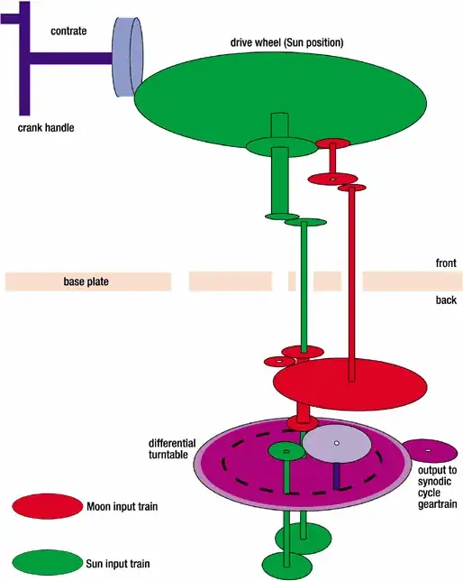

What it is that Archimedes deserves special admiration for we do not actually know, the obvious conjecture is that he used some sort of gear mechanism, but there is no surviving documentary evidence of that. In the Antikythera we do see gears and a differential turntable that would do the trick. In The Antikythera Mechanism: Still a mystery of Greek astronomy? (Astronomy & Geophysics, 41 (2000) no. 6, pp.10-17) Edmunds describes De Solla Price's conjectural reconstruction of how the motion might have been transferred from the driving crank:
"There are 30 known preserved gears in the mechanism. Each gear has been hand cut from a single sheet of bronze. The teeth have all been cut at an angle of 60° and are roughly the same size on all gears. De Solla Price speculates that the mechanism is ‘cranked’ by a now lost handle that turned a contrate (as yet unidentified) gear that in turn rotated a Sun position dial and the main drive wheel. The mechanism then followed three known and one undetermined gear trains. One gear train ended through an inner shaft in the main drive wheel axis and turned a Moon position dial. Another train passes, via the differential turntable (see figure 5), to end up at a synodic month dial and then a lunar year dial. De Solla Price speculates that the third known train drives a four-year dial."
The differential turntable is what, apart from the Mechanism's sheer complexity, sets it apart from all other gearing up to the 16th century. The modern differential is more familiar as the device that allows the inner wheel of a car to travel slower than the outer when turning a corner, but with power maintained to both wheels. The ‘drive’ turns two wheels at different speeds. This process can be reversed so that two ‘drives’ turning at different speeds can then give one output, the sum of the two inputs. The two ‘drives’ in this case come from the Sun and Moon gear trains. One train rotates anticlockwise with the speed of the Moon while the other turns clockwise with the speed of the Sun."

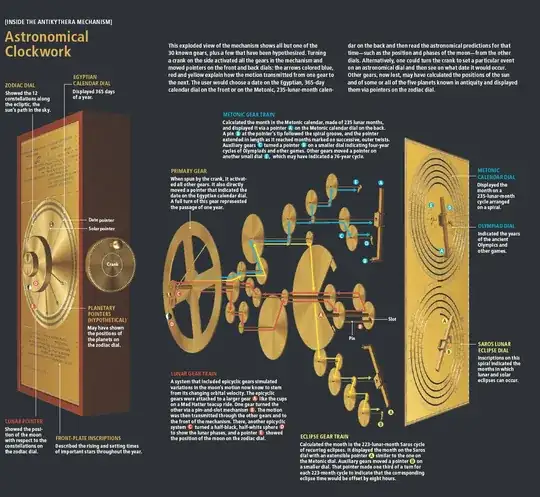

Deepening my researches I found a exploded image who shows all of that structure brilliantly described by Conifold.
Original file hosted here.
