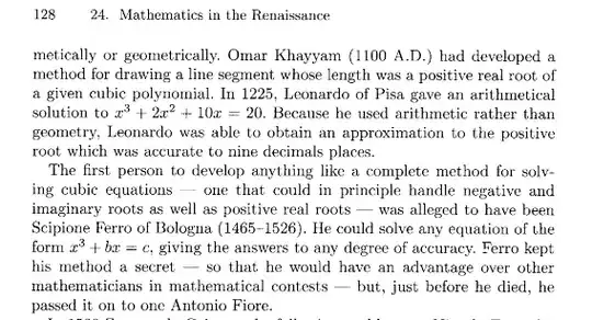

According to an excerpt from The Heritage of Thales By W.S. Anglin, J. Lambek, via GoogleBooks, a method was found: quote
Note that this doesn't indicate a proof that there had to be a real root. The Wikipedia page on cubic equations adds that
Cardano noticed that Tartaglia's method sometimes required him to extract the square root of a negative number. He even included a calculation with these complex numbers in Ars Magna, but he did not really understand it. Rafael Bombelli studied this issue in detail[21] and is therefore often considered as the discoverer of complex numbers.
I don't know when someone demonstrated that complex roots had to come in pairs when all equation coefficients are real; presumably that's what will drive the full answer to the original question.
