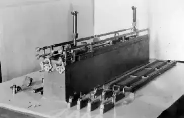

It was actually done with a "tromboning" Michelson Interferometer
(https://www.bipm.org/en/measurement-units/history-si/former-prototype-metre.html)
In 1892 by Michelson. He measured a distance of 10cm to an accuracy of ± 0.00004 mm using a Cadmium lamp . The 1960 re-definition with Krypton used the same data - it was just a matter of measuring the ratio of the wavelengths of the Cadmium and Krypton lines
Michelson's 1907 Noble prize speech describes it http://qsd.magnet.fsu.edu/course/exp3802/optics/AAMichelson1907.pdf
