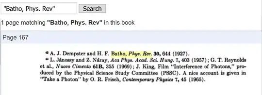

For example, if we use a photographic plate which we must obviously expose for a long time because of the low light intensity, will we observe interference fringes on it? Such experiments have been performed, the first one(42) as early as 1909 which, however, did not make a great impact on the physicists of those days. The first experiment that was carried out under good conditions was published in 1927(43). Monochromatic light of very low intensity from a helium gas discharge passed through a certain type of interferometer and was registered on a film. It clearly produced interference fringes. Later experiments (44) also confirmed that single quanta ended up predominantly in those regions
(42)G. I. Taylor, Proc. Cambridge Phil. Soc. 15, 114 (1909)
(43) A. J. Dempster and H. F. Batho, Phys. Rev. 30, 644 (1927)
