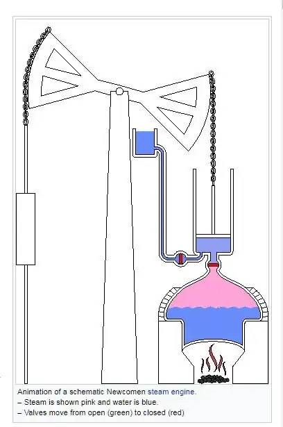

The engine in question does not lift water; rather it pushes water up from the bottom of the vessel. As is clearly shown in the animated image here, condensed steam is forced into the bottom of the lifting pipe. A freeze-frame from that page: enter image description here
So long as the combination of partial vacuum in the cylinder (as steam condenses into liquid) and the net mass (weight) of the piston-linkage assembly is sufficient to overcome the pressure on the outlet valve, the machine will pump water into the upper chamber.
